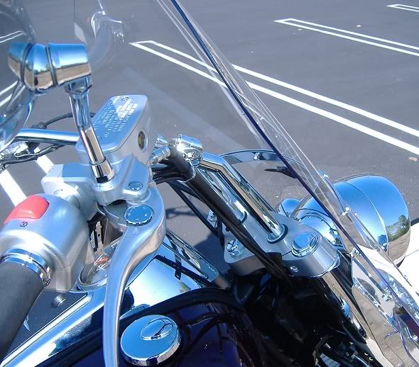

We'll I used the rare bad weather we've been having here in So. Cal to do all the mods I had stacked on my workbench. On my list was my Bully FI Unit, G-bushing, 8" pullback risers, Custom world solo rack and backrest, and last but not least Tsukayu jumbo strong hardbags. It was alot of work but I'm happy with the results.
I had to custom fit the solo rack by drilling new holes in the front support and a hole in my rear fender. Also I had to reroute my cables and brakes to the rear of my triple tree to have enough slack for the risers.

RadGen, the bike looks great!! I love the risers and bar. Backrest matches the big comfy seat you have. I'm going to do the blacked out exhaust this time, I've been a chrome guy in the past so this will be a first for me.
Keep posting changes when you make them.:clap2:
