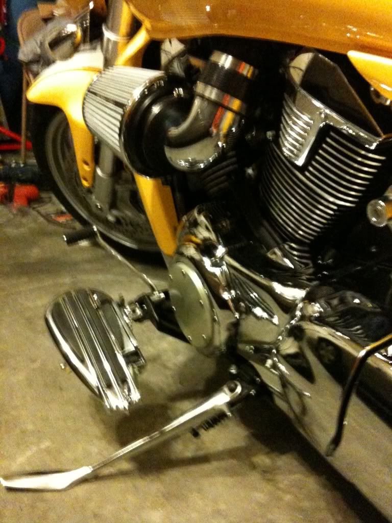

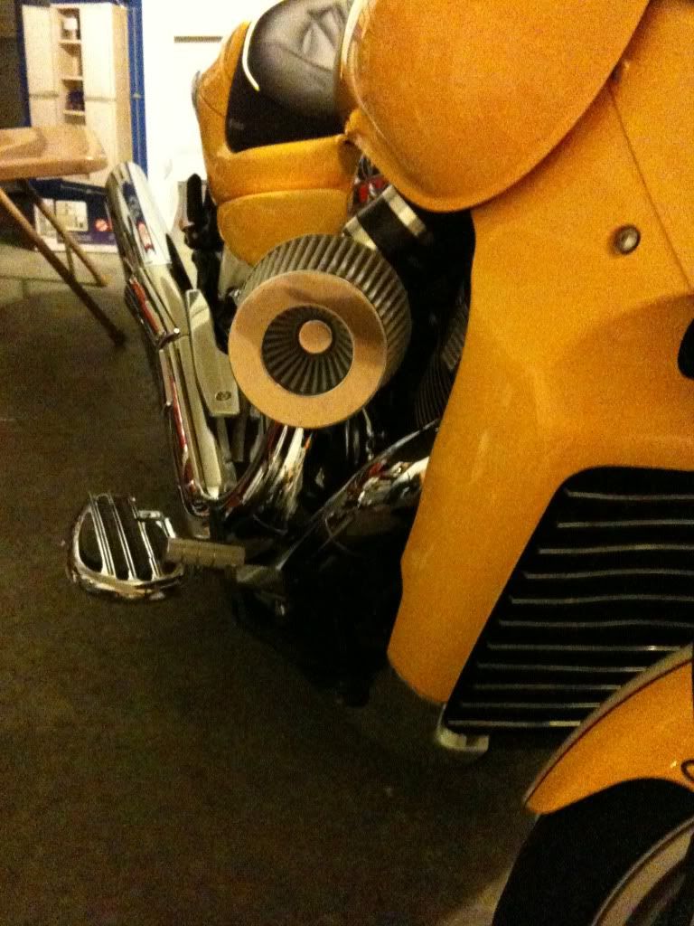

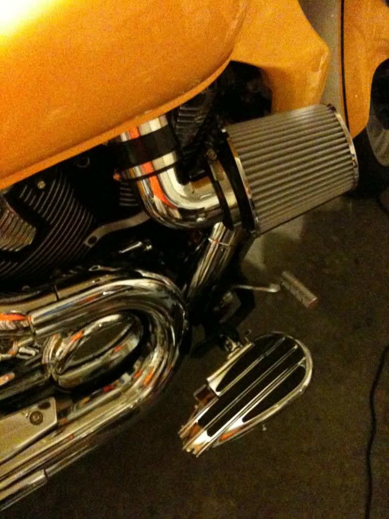

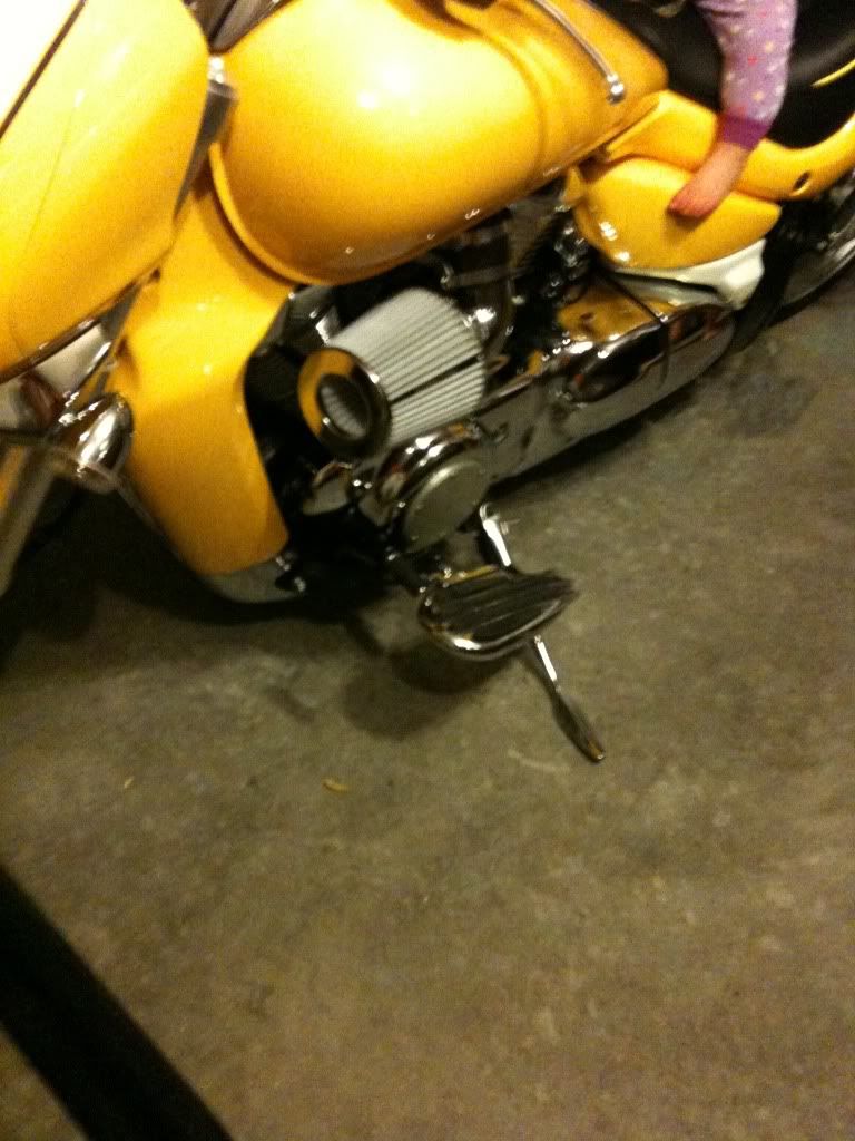

did this under a $100.
300 Posts
sweet:bigthumbsup::drool: i see in the pics that you cant even reach the pegs! jk. looks great

You will need
Spectre Performance - Air Intake Tube
Part Number: 8698 2ea of theses
the elbows should come with this piece it will help bc you will use this to attach the bracket to keep it from vibrating
Spectre Performance - Air Intake Installation Hardware Kit
Part Number: 8711 one of these to put the crank case breather hose into the elbow or you can get the small breathers
Spectre Performance - Coupler/Reducer Combo
Part Number: 8771 you will need two of these also
then you will need a union well i used a 2'' plastic pipe from ace hardware.
but you can get everything from O'Reilly's thats where i got everything.
i will work on a how to here in the days to come but you guys can pm with any questions and i would be glad to help you guys. you guys on this site have helped me out time and time again so thank you for that.:bigthumbsup::bigthumbsup:
yeah and to think thats my good strong leg :a20::a20::a20:

yes it is i couldnt see paying 700 for some of those kits and they have the same basic funtion and work just the same.
