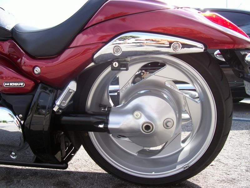

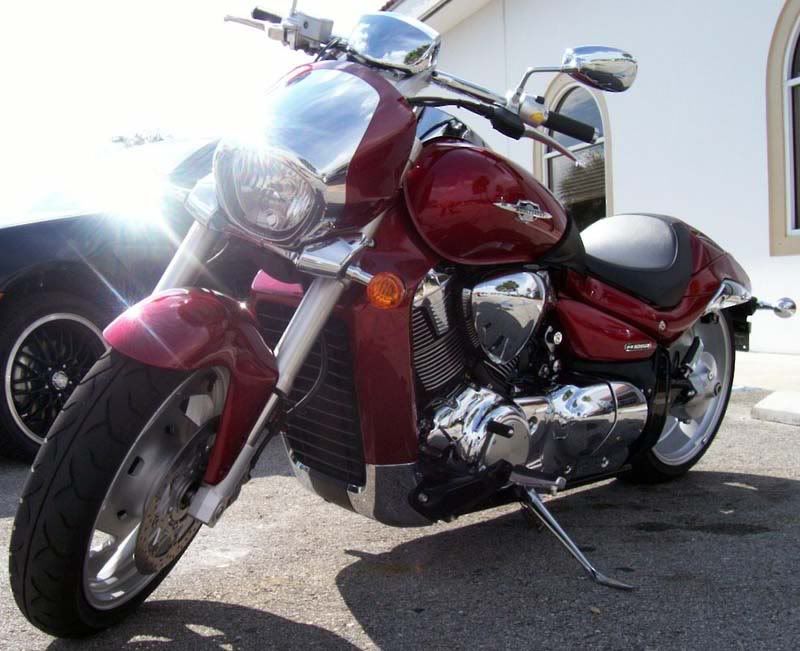

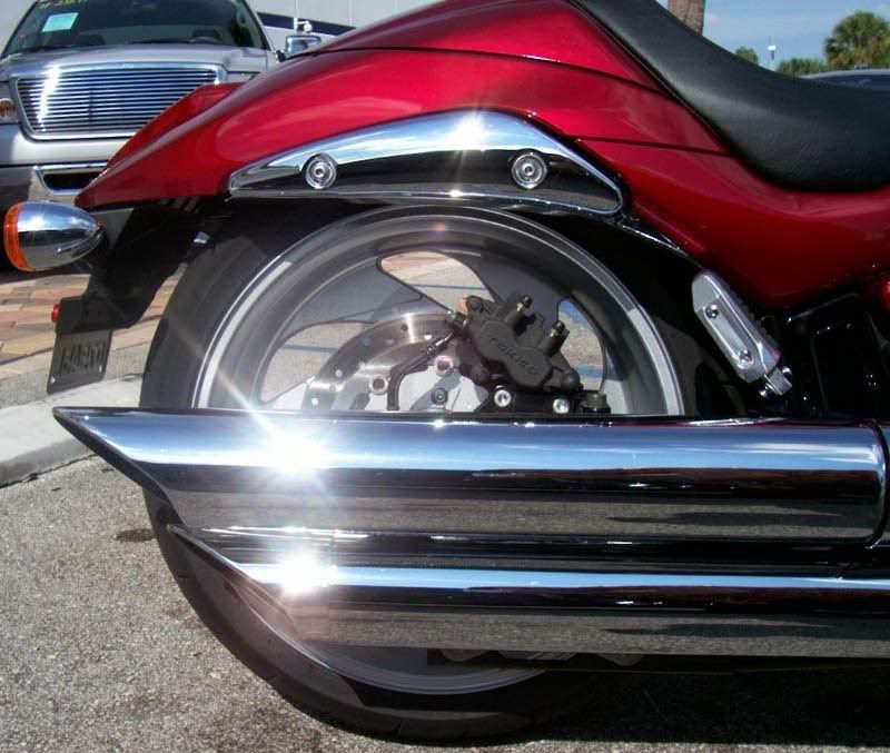

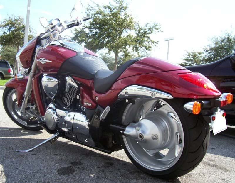

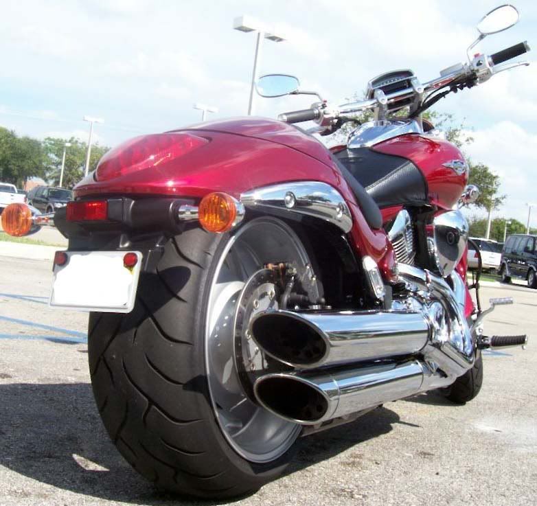

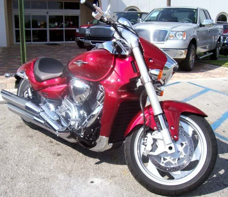

Hal and the guys from DLP developed some bones for us that lower the bike 2.75" and they are available and ready fro shipment.
Very nice quality part and Relatively easy to install.
Thanks to Jim the Junk Yard Dog for all his help. He is very experienced at working with bikes and has helped me, Hal and others with many mods. Junk Yard Dog has pioneered many mods in our bikes and you guys have heard of them through other members. He also got some really cool ideas coming in the pipeline for all of us... I won't spoil the surprise, but believe me when I tell you it shall be really cool...
I pondered whether or not to wait the 2 months for Jason Z's 2.5" lowering bones or just to ride 5 minutes and swing by Hal's warehouse...
In Summation: It took me less than ten seconds to decide I did not want to wait, DLP's service and quality are outstanding and Junk Yard Dog is the man!

It lowers the seat a bit... My point of view did not get affected much as i can still see over cars and such, but the big difference for me came where both my feet are firmly planted on the ground when stopped. I had a problem with the side of the exhaust and having to tip toe that side all the time. Not anymore!!!
It also looks great standing still... I had a customer of mine ask me yesterday: "who's chopper is that?" - I proudly said that's my M109R...
