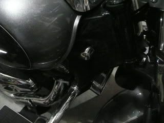

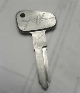

I got this off volusiariders.com Seems like a pretty simple key mod that i think would look good on the 90's... i am going to try it out and i will post some finished pics hopefully this weekend.

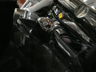

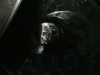

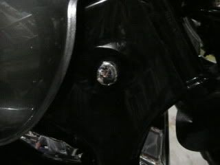

It's probably been done before, but I thought I'd share the key mod I did for the wife's C50 ...

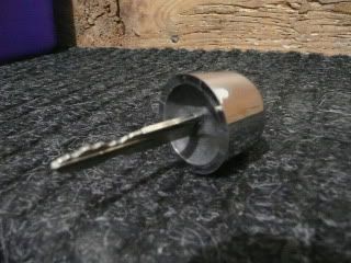

Get one of these chrome toilet bowl caps from Lowes or Home Depot.

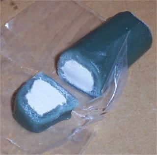

Pick up some JB Stick Putty at your local automotive store.

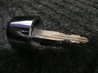

Take your spare key and cut/grind the top until it's the appropriate length.

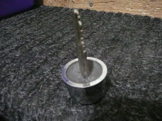

Cut up some putty and fill in the cap cover. Insert your cut key and ensure it's centered and straight before it dries (it dries quick - within minutes). Let it set for about an hour and you're good to go.
Perfect fit ... looks like it belongs.
