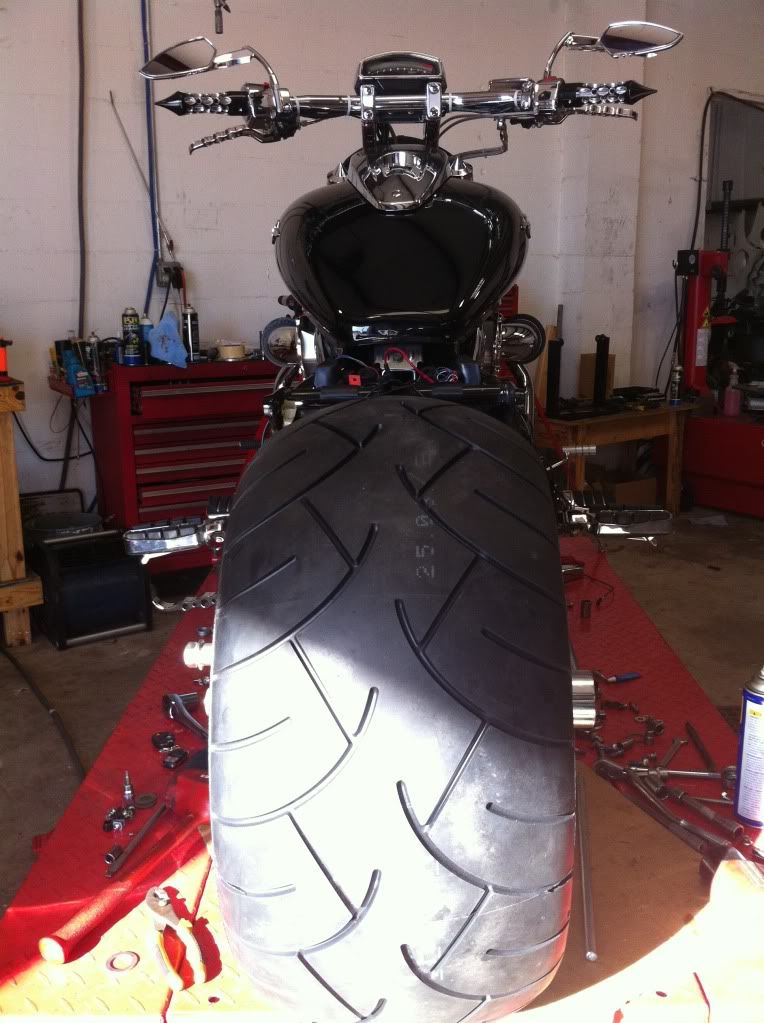

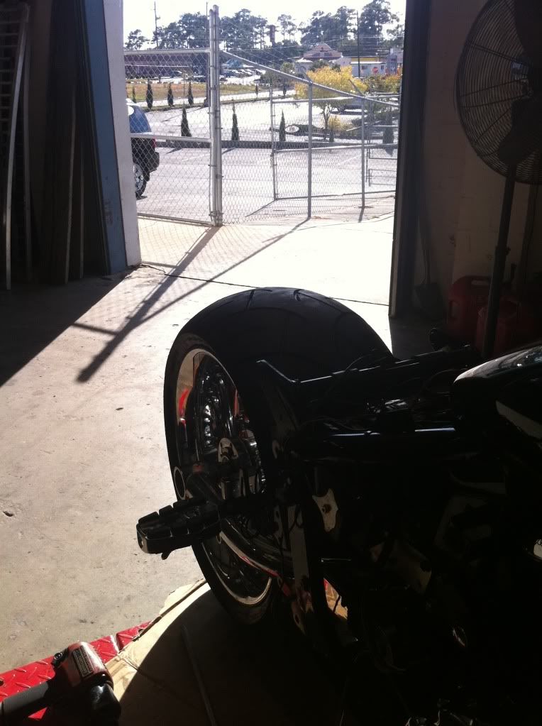

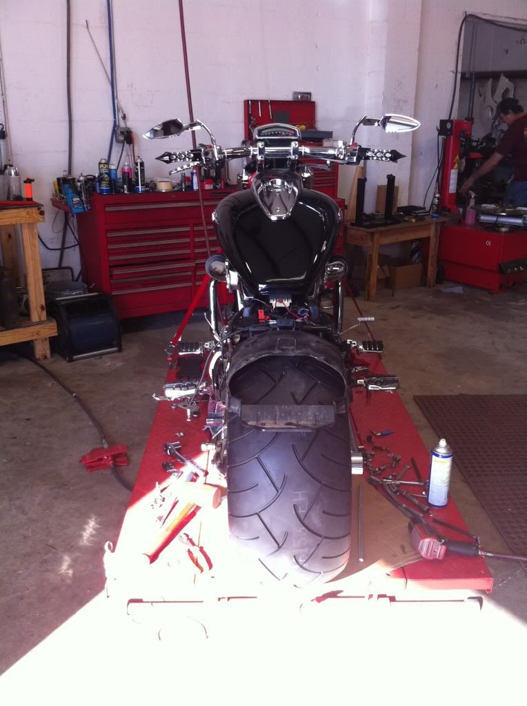

I started the upgrade to the 300mm club! I ordered the DLP swingarm, they only had black so I sent it to Jerry to chromed and received it late last week.
Work is is in progress and hopefully will be done this week so I can ride! We still have to work on the fender to get the fatty to fit, but we'll get there.
It's funny how 3/4 of an inch difference can make such a difference between the 280 and 300, but I likey.
Here are some pics of the progress.
It looks like my bike got rear ended.

I'm not sure how many hours yet, we'll still working on it. The mechanic is working on getting the fender worked out to fit. There are some ridges under the fender that need to be removed to get the tire to fit.
I'll let you know how many hours he has into it when he's done.

You also have to get the DLP swingarm (which is usually back-ordered), modify the ridges under the fender (cut them out and re-weld if you want to lower the bike), and shave a tad off the left side of the tire. That's what I know to this point.
