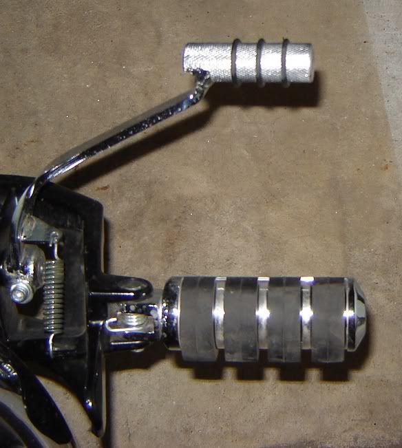

Here's the part number for some o-rings that fit the brake pedal. I didn't think I needed them until riding home from work in the rain a few days ago and my boot slipped off the pedal :eek: Any Pep Boys, Autozone, Checker, etc. should carry this brand.

I've seen several pictures here where guys had put o-rings on the pedal. I just never gave it much thought 'til I was dragging a boot behind me in the rain the other day :confused:
Thanks Trouble, for once, I just happen to have 3 of those laying around. Put them on. Cheapest mod ever. Looks good too. Thanks bro.

Sure enough, had some laying around the garage first day I brought it home they went on. Like it! Been on ever since.

I've had them on mine for a month now. Buy extra ...... they will eventually slip off. :bigthumbsup:

My outer one falls off too... ::) came off at a light once, I thought, "I'm gonna bend down and pick it up... " then I realized how bad it would be to tip the bike over for a $.75 o ring... Changed my mind quick... :p
Maybe a couple drops of super glue. I lost mine on Sunday and was thinking of trying the super glue to keep them on. I think since we pivot our feet on the brake pedal that is why we are loosing them, especially the outer one.

Lost all 3 on a 350mi ride over two days, will try the 3/4 though.

Put on 3/4 * 9/16 * 3/32 and let me tell you I don't think they will come off any time soon, it was alittle of a pain getting them on. Buck something a box of 10 at lowes Danco brand.
