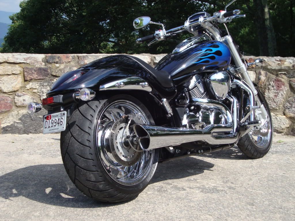

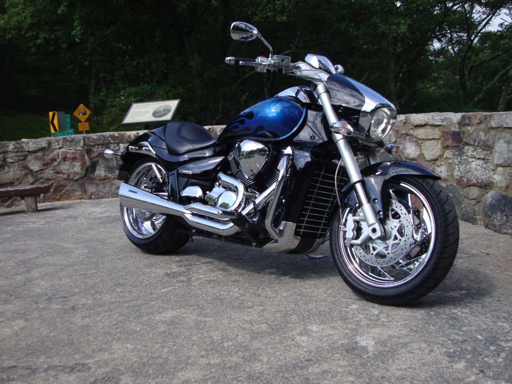

I just installed the new Cobra Tri-Pros. :hot::hot: Thanks for helping me futurR (Matt)! :yourock: They look and sound great. The build quality is really good also. Many thanks to Cobra for making a great pipe. It was a HUGE bonus that they were able to get it to me at the meet. :#1: Everyone loved it.

I just installed the new Cobra Tri-Pros. I will post photos and a sound bite within the next day or two. They look and sound great. The build quality is really good also.
