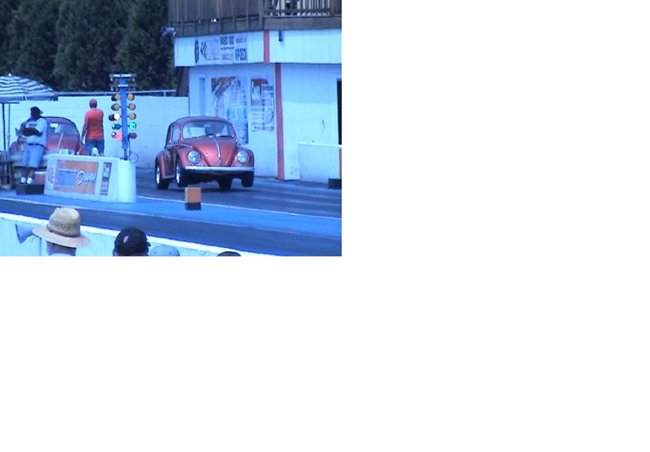

went to piedmont drag strip in N.C. took third in the pro class......red lit in the semi's by .018....dohh! :redfaced:
92 Posts
that bug will run 7.60 in the 1/8th and has turned 12.75 in the 1/4 still not tuned all the way .....I would give alot of 109 riders a run for there money with that bug!!!!plus it is street leagal!

92 Posts
top secret!!!
2332cc
48 mm webber IDA's with 42 vents
port and polished heads 42mm intake x 37.5 exhaust
1 3/4 merged header
c55 cam only .512" lift
launch @ 4000
shift @ 7000 3 more times
hit the traps around 12.70 @ 105 bumpin the rev limiter crossing the line!!!! :D
