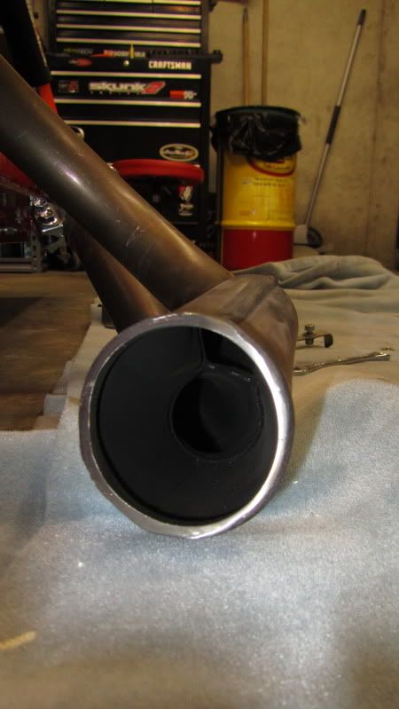

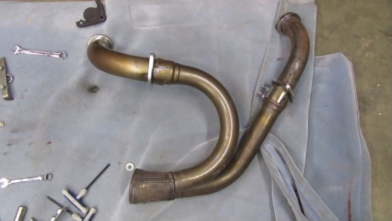

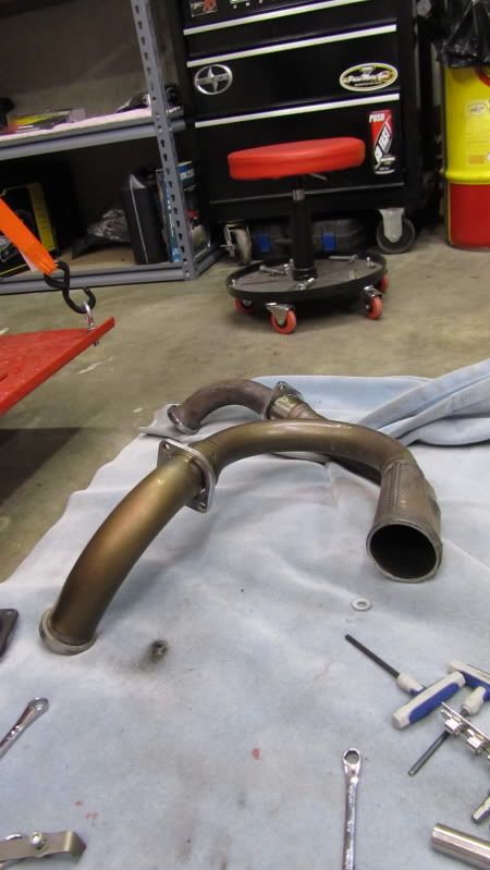

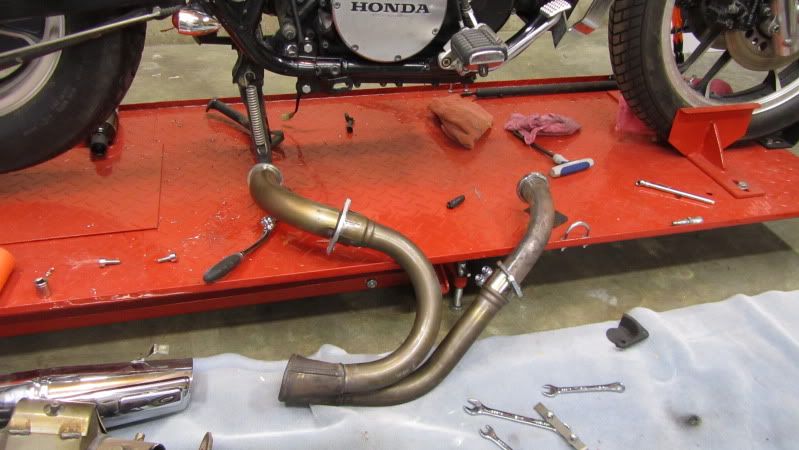

Well i got sick of my stock exhaust taking up room in my garage and so i thought why not try my hand at something "custom". so i will be searching for something new and "neat" for the hammer (my 109). all i need now is a muffler and some black heat wrap.
if you guys know any good places to find good mufflers please let me know! im looking for about a 14inch muffler.:bigthumbsup:

Forget a muffler. put a turn down tip on that and run it. It is WAY LOUD! Trust me, I ran that for about 2 weeks.
If your local pep boy has gotten the new 'Speed Shop', that is a great place to go. My local store sectioned off 1/4 of the store to tuner type parts and their stock on mufflers is huge.
23,526 Posts
It's easy to do what I did and put a chrome exhaust tip on it, then stuff a glass pack muffler in it. I've got one tip that has a 12" muffler in it, and another that has an 18". The 12" is just a little too loud but the 18" sounds great. That's an 20" body, the overall length is around 24". You can get all kinds of tips in different sizes and lengths, and either turn out, slash cut, rolled edge, etc.
Or get a SuperTrapp and stick that on there. For any of them all you have to do is make up a connector pipe to get you from the head pipes to the muffler.
CHERRY BOMB!!!!!
LOL
actually I saw a youtube clip somewhere's.....a guy had a sportbike exaust welded up and that sounded friggin awesome
