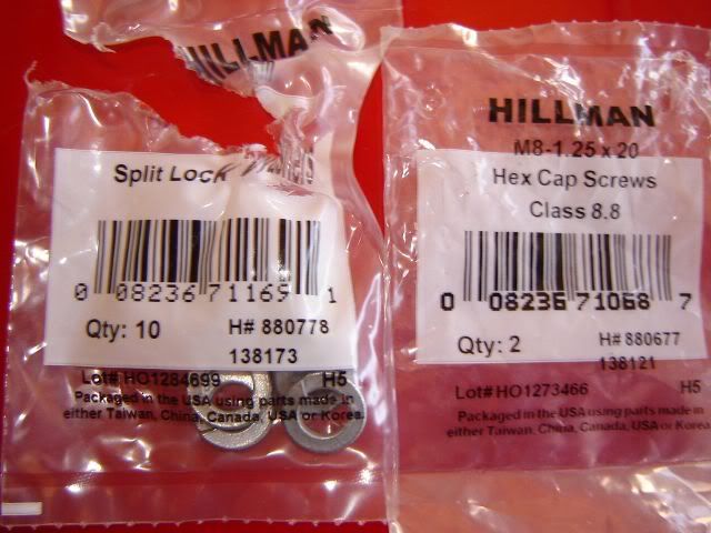

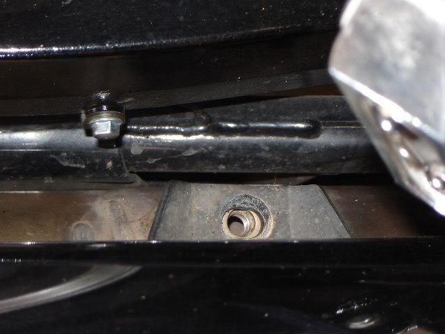

I noticed a couple days ago that one of the exhaust pipe mounting bolts (directly below the passenger peg) had worked it's way out. Finally figured out where the rattle was coming from :confused: Made a stop by the local hardware store and got some replacements - $1.60 total :D Here's the info for anyone who has a similar experience:
Original on the left, replacement on the right

Yep, mine backed out and was lost while riding in Florida. Stopped by Suzuki shop in Ft. Pierce and they didn't even want to talk. Said we probably don't have anything to fit that bike yet. I told him just any bolt would work with right threads. Said we don't have any. I left and stopped in Stuart, Fl. at Suzuki shop and people couldn't have been any nicer. They got me a bolt, put some lock tight on it and replace it for me. NO CHARGE!! I bought a couple of shirts from them and on my way. Some a$$holes and most not!
Mine worked its way out too ........ ordered one from local dealer and have a bottle of locktight waiting LOL :bigthumbsup:
