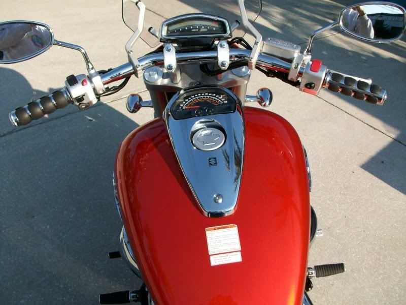

What have you guys used as far as cruise control or a throttle assist that works well? After 30+ years of doing bodywork and painting, I have some carpal tunnel problems and my hand and wrist go numb or hurt after riding a while. What different throttle assists work best? Here's the hand grips I have. Thanx, WILDMANN

You can put a throttle boss on the ISO grips you have. It helps quite a bit with relaxing your throttle hand, and it's cheap.

You can also do the Lamonster throttle lock for about $5 or less and a few minutes of work.
Lamonster Throttle Lock (updated)
It looks something like this when added to the bottom of the control housing. Easy to reach and you can not only lock the throttle at any position, but also adjust it to just slightly hold the throttle so it takes less effort.
