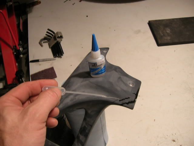

After looking at my new gelcoated chin spoiler I noticed the scratches would not sand out.
From my layup experience I see the gelcoat has cracked most likely from pulling from the mould. It happens...
It is my opinion that after an expensive paint job these cracks will migrate through the paint soon and be an irritation.
I believe I have a good fix to prevent this heart break...I bought some Cyanoacrilate Glue (Xtra thin) and pulled open the crack a little. a tiny drip of this thin stuff will wick all throught the crack and harden in seconds bonding the gelcoat with an easy to sand plastic

No. The "tweaking" wouldnt do that...I think
When I pulled parts from a mould sometimes a tight compound radius would stick needing a bit more pull and crack the green gelcoat if not careful. The parting agent might be too thin too. Thats just my experience

patch
to be safe i would put a glass patch behind to make sure of no stress. used to spot drill end of crack so it could not go any farther, nows the time to late after it's painted
IMO, I would request a replacement. Even at the group buy cost, it was still expensive. You should receive the quality you paid for.

Mine had a crack in it coming from the bolt hole. My paint man said it would come thru the paint and said he would have to sand it down a reglass it costing me money. So I called Low and Mean and they sent out a replacement. I haven't gotten it yet. Will come in this week, I hope this one is better.

Cool. I figured Gelcoat is not structural so a crack wont be anything but a cosmetic issue

I sure hope they check them out for cracks before the "chrome" treatment. Vibration has a tendency to cause crackes to spread.

I bought a chrome chin from them 2 years ago when they first came out. It has held up pretty good. It did take about 6-8 weeks before I got it. I was told then that Low & Mean makes the chin and then sends it out to be chromed. It is then drop shipped from the chromer to the customer (you). So, if the chromer has other work as well as the current large order of chins from Low&Mean, then the process will take longer. Hopfully they still use the same chromer since mine came out very good and has held up well. Side note: I took mine off and am now having it painted. As for those who received chins with cracks and are undertaking your own repairs. I personally would not do that. Group buy or not, you paid for a product and should get what you paid for. Send it back and get a new one, instead of repairing it and then investing money in paint only to have the cracks come back when the repair does not hold up. Cracks are poor castings or materials not mixed properly causing them to fail.
