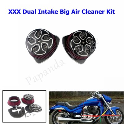

was going to buy k+ns for the bike but i did a bit of homework and found these .. will they deliver colder air if you block the rear of the airbox off and are they any good ? i know they are from china but they look like all the other ones from around the world ...

Without knowing how fine is the filter mesh itself and its square inch area in comparison to KN SU-1806 its hard to compare. If you block the hot air you will definitely deliver colder air from outside of these, I would like to compare openings on the back of these versus openings of the KN SU-1806.
They do look nice and the price is attractive as well...

the way i look at it is the factory filter breaths warm air in from a hole at the rear as you know and that hole in my opinion is smaller than the original pipework that goes to these ..
here's a guy fitting something similar but he doesn't block the hole at the rear ...

They look to be close to the same size as the LA Choppers XXX, Arlen Ness, or Kuryakyn of the same type of design. Honestly, almost anything is an upgrade over the stock filters. Those look like they have a mesh type filter similar to a K&N, so you can clean and reoil them.
I noticed in the link you provided that their are other sellers offering the same intake for less too.

The Barrons/LA Chopper intakes like this are good quality and move plenty of air.
I am running Barron XXX intakes on my bike at the moment.
The Chinese knock offs are built a bit cheaper and the filters are not usually oiled on the knock offs. Not sure if the filter material that comes on the knock offs is even an meant to accept oil.
Barron and LA Chopper intakes are usually around $400.00 (USD)

Those say they are "Clean and Reuseable",. Normally it would say "Cleanable and Reoilable"
They might mean you can blow them out or vacuum them, who knows.

LA Choppers BigAir xXx on mine for several years, since 2014 I recall. Also installed the same on a friend's bike in 2015. They work great since they are so large in comparison to any other filter setup out there. You have to like intake noise with these.
