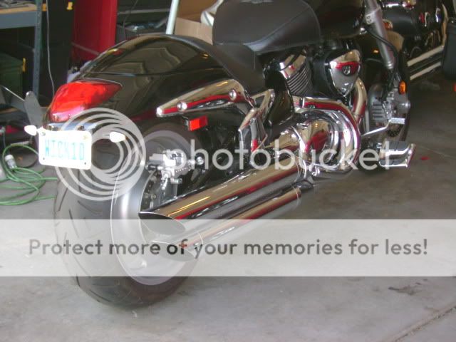

cleaned up my rear end a lil bit.
before
after :

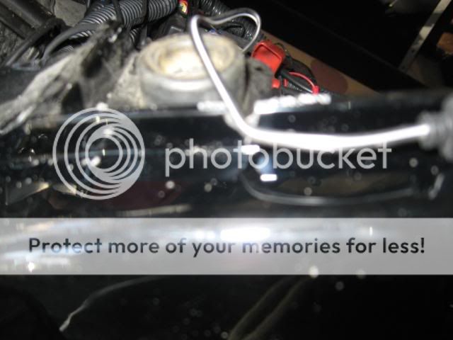

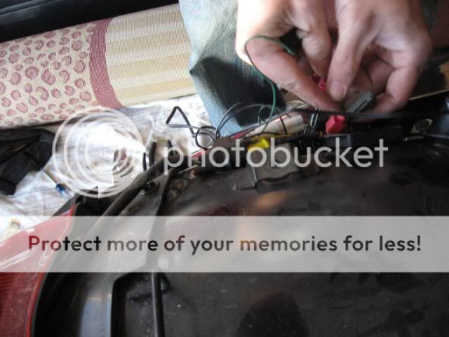

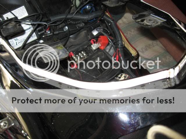

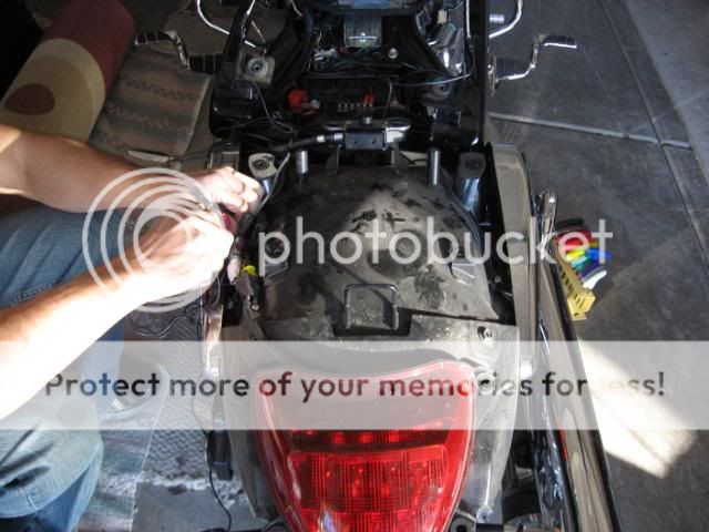

removed old turnsignals and hide some led strips under the rear cowl, fits perfectly with passanger seat as well..
cut some notches to run the cords thru
wiring..
p.s those are stock pipes fully debaffled :-0 (first)
