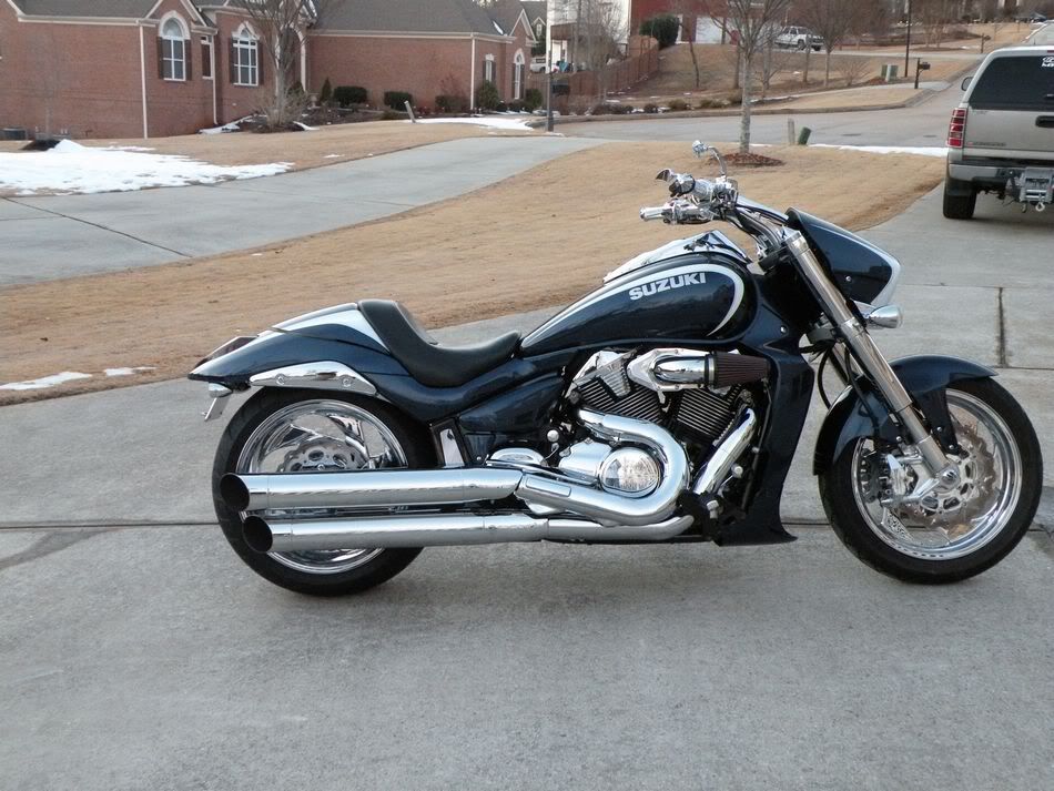

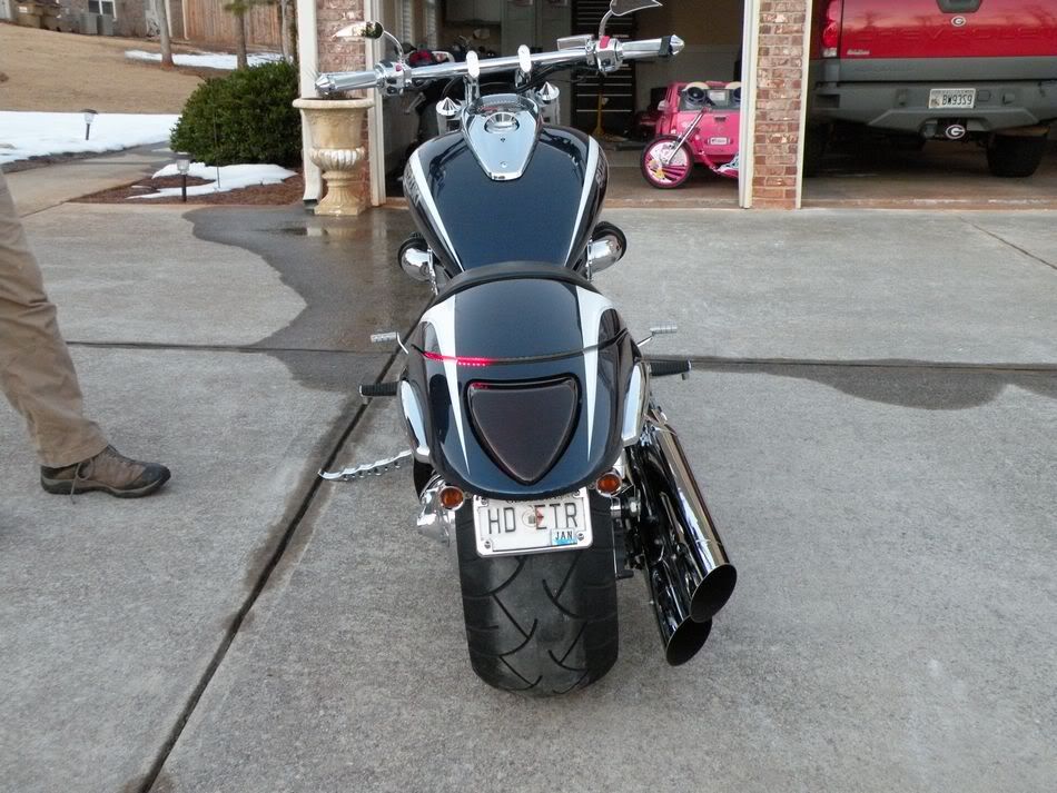

With the help of Chad (LUCKY), I was able to get my air ride installed today. In all honesty, it isn't a hard install. I was asked to do a step by step "how to" but the instructions that come with the kit are very good. The only points I would make are:
#1) The stock shock mounting bolts were on there tight. I wasn't strong enough to get them off by myself....I tried last night and had to wait on Chad. They are supposed to only be 32.5 ft/lbs but they were way tighter than that!
#2) The suggestion to use some grease on the thrust washers to get them to stay in the shock mounting bracket was a great tip. We stuck them to the sides of the bracket, slid the shock in between, slid the bolt through, and then tighten them to spec....32.5
Here is a video and a couple pics:

Looks great Bobby! And it works at about the same speed as the KM air ride. :bigthumbsup::bigthumbsup:
The first time I had to remove my bones, I put a long pipe on the ratchet handle and lowered the bike down on it to break it loose.
